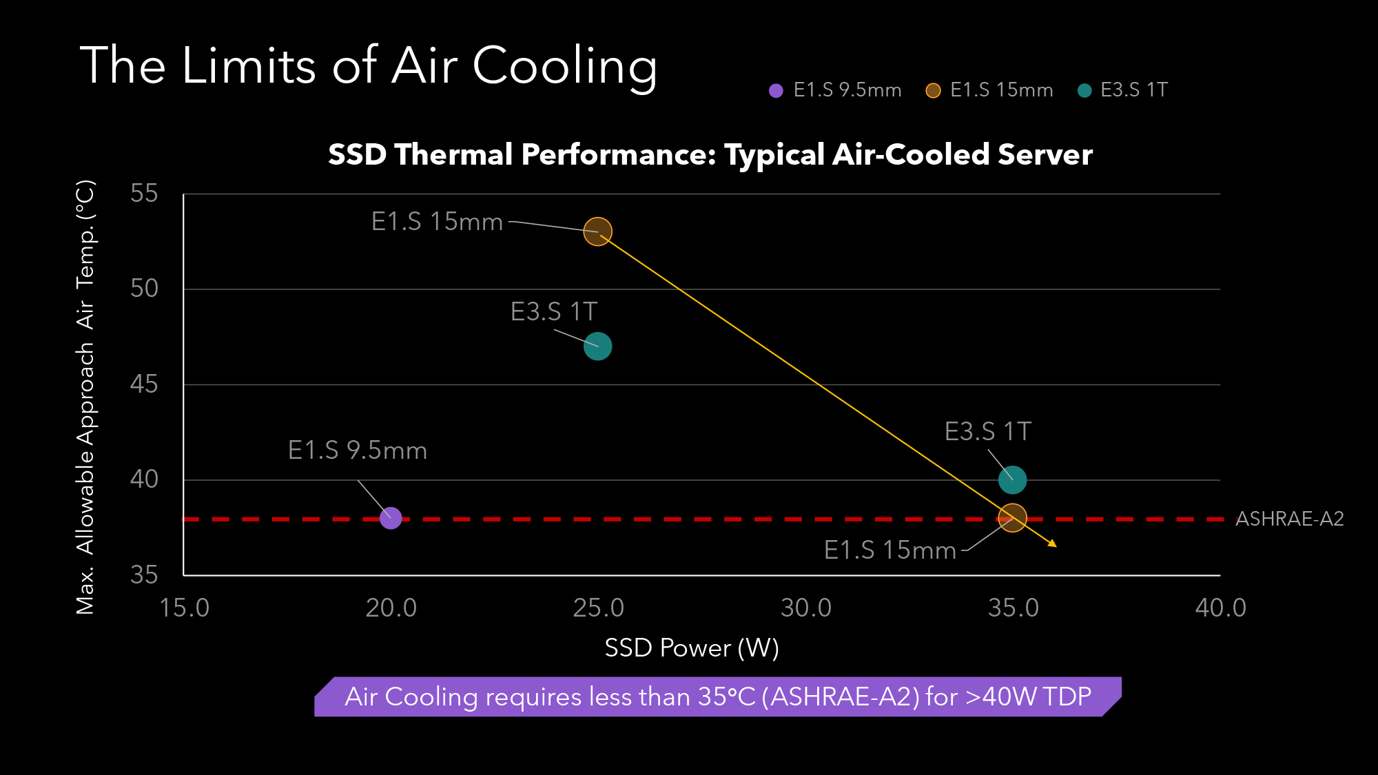

Physical and economic limits of air cooling on high-power SSDs
Figure 2. Limits of air cooling
Limits of air cooling for SSDs vs. Solidigm cold plate cooling solutions
When SSD power consumption moves toward 40W to 60W:
  • Air inlet conditions below 35°C are required
  • Higher airflow and more fans are needed
  • Energy consumption and noise increase significantly
This not only increases cooling costs but also limits system density.

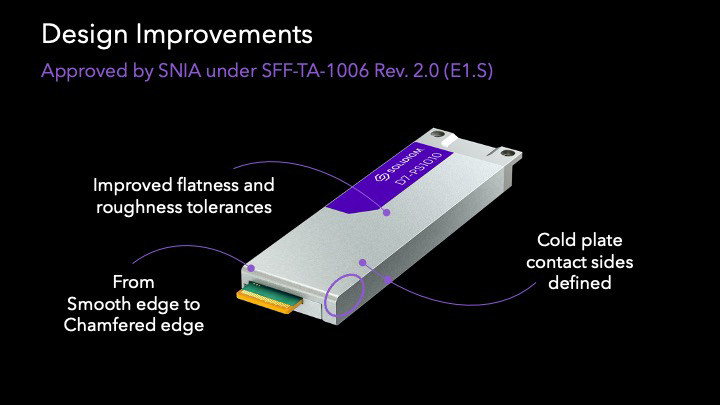

Standardizing liquid-cooled SSDs is a critical step toward enabling high-density, energy-efficient, fully liquid-cooled data center architectures. Leading industry players are actively driving the development and adoption of formal specifications. Solidigm, in collaboration with SNIA, has released the SFF TA-1006 (Rev 2.0) specification, which defines the liquid-cooled implementation for the E1.S form factor and marks the transition from proprietary, custom-built solutions to open, reusable industry standards.
The specification tightly defines parameters such as cold plate contact area, surface flatness, and roughness tolerances to ensure predictable and repeatable thermal performance. In addition, features such as chamfered edge design address mechanical insertion and removal challenges under high contact pressure conditions.

Figure 4. SSD cold plate design improvements
Solidigm cold plate design improvements for SSD cooling solutions

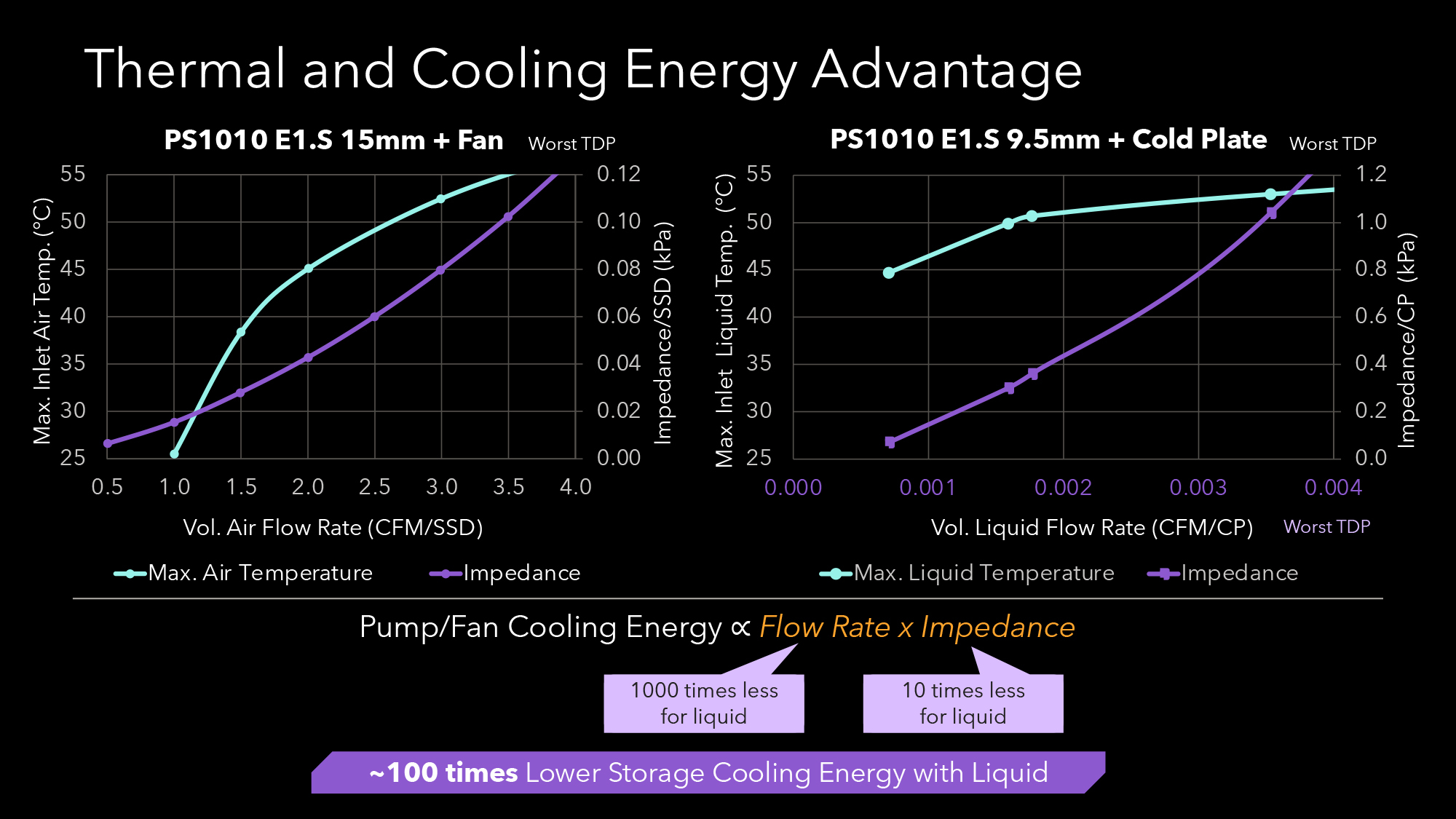

At the server level—and even across the entire data center—liquid-cooled SSDs deliver not just localized optimization, but overall improvement in system efficiency. Compared with traditional methods, liquid cooling requires much less energy usage than air cooling under the same heat dissipation requirements, and when combined with a higher-density, fanless design, it greatly reduces rack space needs and the complexity of ongoing operations and maintenance. This architectural streamlining translates directly into meaningful improvements in data center energy efficiency, creating gains from the component level all the way to the overall infrastructure.
