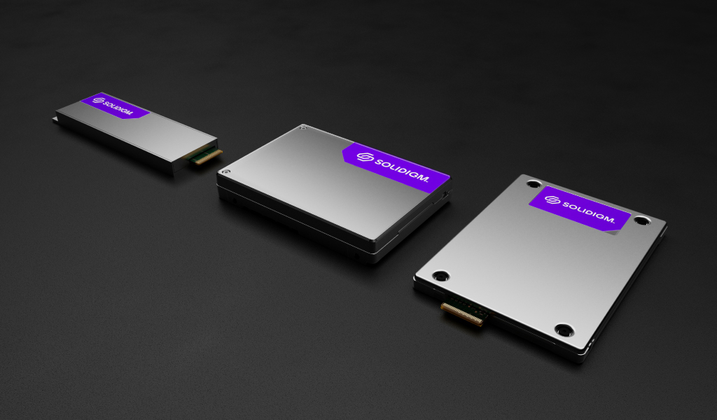

Mapping the solidigm portfolio to edge needs
Solidigm D7-P5810 for caching tier storage, Solidigm D7-PS-1010 for performance tier storage, Solidigm D5-P5336 for capacity tier storage.
The table below illustrates how three drive options align with the cache, working, and capacity roles inside a power-limited edge server.
AttributeSolidigm™ D7-P5810Solidigm™ D7-PS1010Solidigm™ D5-P5336
CategoryCaching TierPerformance TierCapacity Tier
Edge AI RoleWrite-burst cacheHot model and index store Large context and retention
InterfacePCIe 4.0 x4PCIe 5.0 x4PCIe 4.0 x4
Form factorsU.2  15 mmE1.S 9.5 mm,
E1.S 15 mm,
E3.S 7.5 mm,
U.2 15 mm.
U.2 15 mm,
E3.S 7.5 mm,
E1.L 9.5 mm
Sequential Read≈ 6.4 GB/s≈ 14.5 GB/s≈ 7 GB/s
Random Read≈ 0.9 M IOPS≈ 3.1 M IOPS≈ 1 M IOPS
Capacity Range0.8–1.6 TB1.92–15.36 TB7.68–122.88 TB
Endurance (DWPD, 5 yr)  ≈ 501.0≈ 0.5
Idle / Active Power5 W / < 10 W5 W / 23 W (avg)5 W / ≈ 25 W
A practical layout pairs a couple of cache-tier SSD drives for ingest spikes, a small bank of Gen5 performance-tier SSD drives for the active set, and one or two high-capacity SSD drives for context data. Matching endurance to write pressure, bandwidth to accelerator demand, and density to retention needs converts edge constraints into breathing room. With the right Solidigm tiers in place, cloud-class AI can live at the storefront, on the factory floor, or beside a rural feeder line without hauling a full data center budget along.
