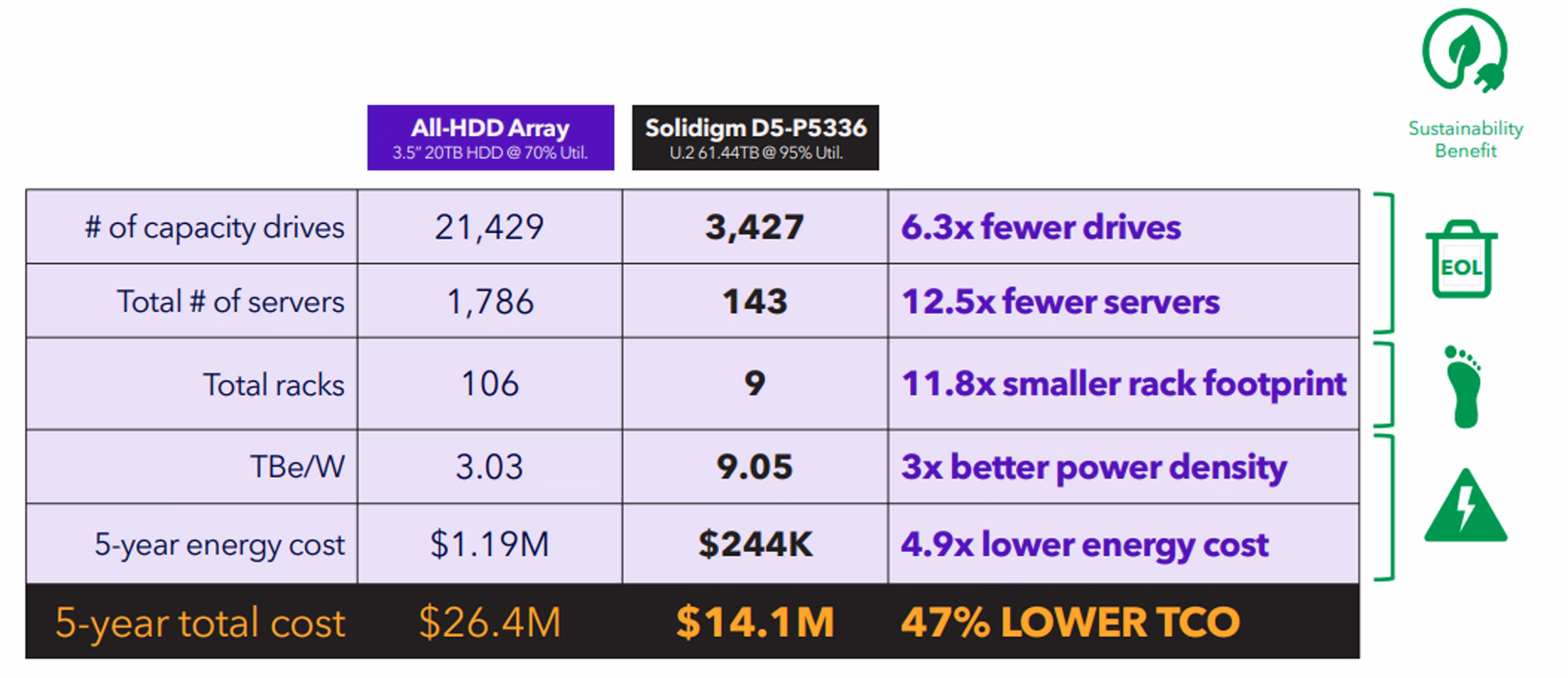

Total cost of ownership for all HDD array vs QLC D5-P5336
Table 2. TCO value when solving for 100PB object storage cluster
Table 2 presents a TCO cost-benefit analysis demonstrating an impressive 47% TCO saving when comparing QLC to HDD over a five-year span. These savings encompass reductions in rack space, energy consumption, labor costs, and the added advantage of a significantly reduced end-of-life disposal footprint, contributing to enhanced sustainability.
