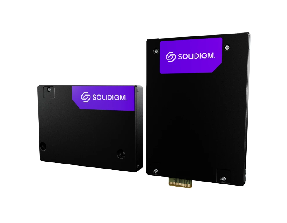

Device Attestation PS1010 and PS1030
Obtain Solidigm Attestation Root Certificate Data for the D7 the D7-PS1010 and D7-PS1030 to verify the digital signature and security of your SSD.
